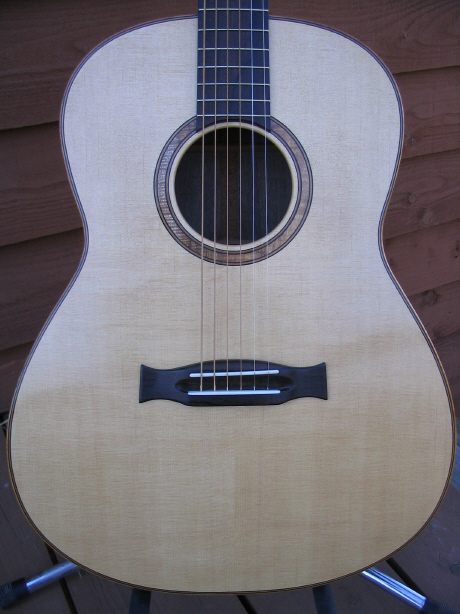

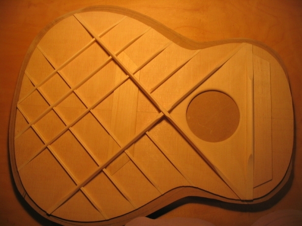

Here's a photo of the bracing I did on the guitar I built in my class with Sergei:
Here's what the top looks like from the outside:
This guitar has a sitka top and black walnut b & s. It is mid-sized, with a shape of Sergei's design (his "SS" - standard steel string). 65 cm scale. The sound gets rave reviews from everyone who plays and hears it. Not the biggest bass sound in the world, but a very nice, clear, defined, "piano-like" bass. Excellent mids and highs. Very lively, colorful sound. Good note separation. It does everything it's asked to do. It just LOVES to sing, and does so with gusto, fortitude, and spirit.
Todd Rose
Ithaca, NY

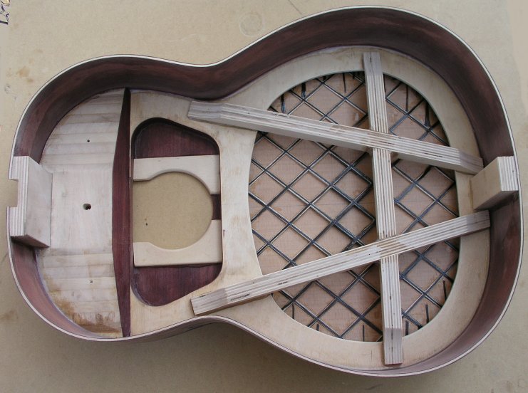

It looks like some of you have tried the lattice top. Building in the Australian "lattice" style also means arching the back like a cello by using laminates (no back braces), as well as stiffening up the sides so they don't move as much which transfers more evergy to the top and gives that HUGE volume associated with lattice guitars. Here's a pic of the inside of a typical Australian type lattice guitar before the back is attached. I'd really be curious to see if anybody has built a back/side combo like this on a steel string.
